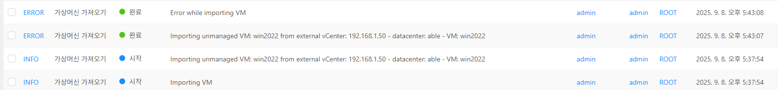

agent.log 파일을 보면 다음과 같은 메시지가 표시됩니다.
virt-v2v: error: filesystem was mounted read-only, even though we asked for it to be mounted read-write. This usually means that the filesystem was not cleanly unmounted. Possible causes include trying to convert a guest which is running, or using Windows Hibernation or Fast Restart.
